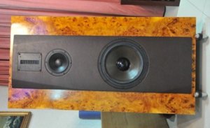

  4. VQ_audio
    VQ_audio Advanced Member
